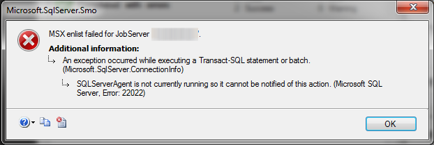

    • SQL Server Agent needs to be running. If this is not the case, you will see the following error:

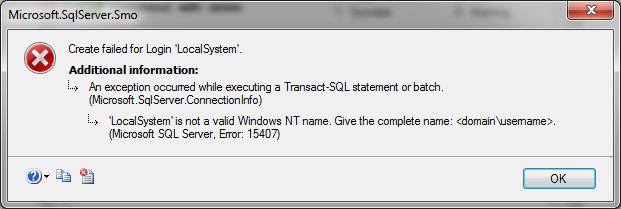

    • SQL Server Agent needs to be running using a qualified network account. So the 'LocalSystem' account will not work:

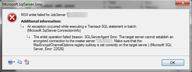

    • Sql Server Agent should be configured to either support encrypted connections, or to disable SQ Server Agent to use use encrypted connections.
